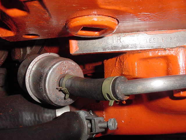

    I have a friend interested in a 68 435 conv. in the Houston area. While he has several newer vettes, this is his first vintage purchase. I told him about the NCRS & that there may be someone in Houston area that would be willing to check it out with him for a fee. Tom O'Grady from TX chapter rec. Houston Cor. Service.
    1) Any other recommendations (he is going there this Thursday)?
    I told him about the 67 "issues" and doubt that someone would go to those lengths in a 68, but...
    2) I have a pic of the pad area so if anyone comments on it, it would be very appreciated.

    From what I can tell, the numbers look acceptable, however, a better photo would reveal a lot more. Cannot see if the pad has the proper broach marks.
    Kent #6201

      I suspected that it wasn't close enough. He has asked for a better one.
      Thanks
