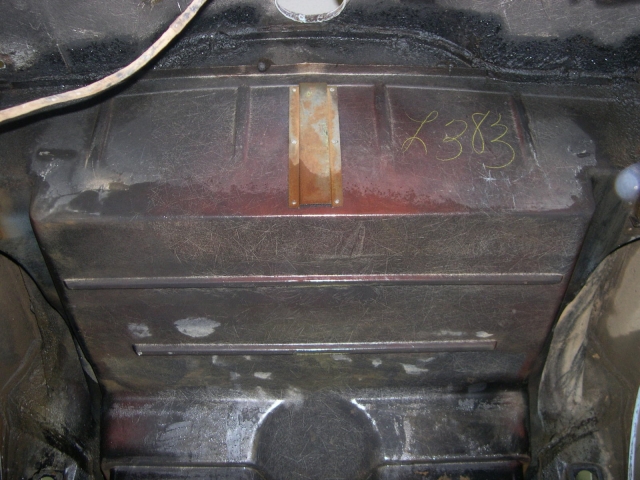

        Jack, if this uploads, I'll post other photos of the job number that I found on my car when I restored.

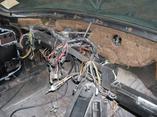

          Re: C2 Job Number
          Here's the job number that I found on my steel dash support.

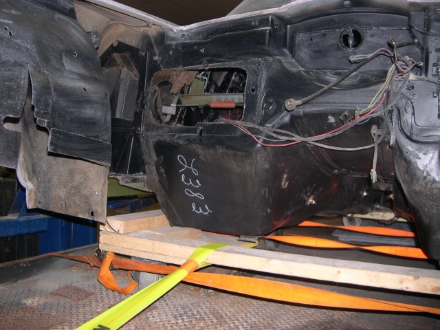

            Re: C2 Job Number
            Here's the photo.

              Re: C2 Job Number
              Here's the restored pass side firewall. It was very light after I cleaned up the area, so I just traced over it with another grease pencil. It is exact though.

                Re: C2 Job Number
                Tony,
                Your body number of L383 is typical of the other AOS body numbers I have seen. Your body would have been number 6,383 in the AOS production sequence for 1967. L is the 12th letter in the alphabet multiplied by 500 for the series run, plus the 383 equals 6,383.

                  Re: C2 Job Number
                  Thanks Don. My Trim Tag identifies my body as A-1967. Pretty cool to have the 1967th A. O. Smith coupe body for a 1967 Corvette!
