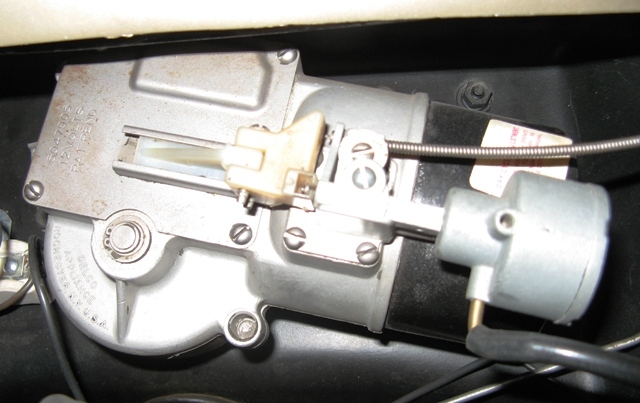

    Hi,
    I have this 5047905 wiper motor in my May 1st '62. It works fine, but according to the judging manual it is not correct. How many points would this cost me? Who would be a good source for the correct motor?

    Re: '62 wiper motor, how many - points?
    You'll lose points for:
    Wrong serial number plate
    Incorrect configuration--shouldn't be the type with the snap ring on the shaft
    Sticker on the "can"
    The "can" portion being painted black rather than plated
    Number of points lost will be up to the judges.
