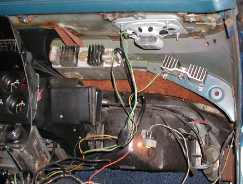

    Here's my 71:
      • 43221
      Re: '72 Amplifier Location.
      Patrick and Scott-----
      Yes, however, this is an installation for a car with U-79 stereo radio. If Scott's car has just U-69, then he would have only the "convector", the device on the right side of the photo. In fact, I think that I can see at least one of the holes for the convector mounting in Scott's photo.

            Your copy of the AIM will show you the approximate mounting location for the components NOT contained within the radio chassis. Early Shark cars like the '72 in question use a 'convector' module on the base radio that mounts to the upper RH brace beneath the dash. One version of the convector works regardless of car configuration.
            If you have a stereo radio, consult the AIM under section U79. The convector unit is NOT used and is replaced with an adaptor assy. There are two versions of the adaptor: one for base cars and another for A/C equipped cars. The general mounting location is shown in the AIM.
            Last, as technology moved on, the adaptor was simplified for later versions of U79 around the mid/late 70's. The adaptor became a simple, 2-channel convector--a heat sink with DS-501 audio drive transistor(s) on it. Do NOT confuse/mix the various versions of the stereo adaptor!
            If you see a car with a convector AND an adaptor under the dash, suspect someone has changed the configuration of the car from base radio to optional stereo radio....

                  OK, when you get your copy of the AIM you'll see the only A/C impact comes from the optional AM/FM/Stereo radio and which adaptor is used. U69 is the base AM/FM radio and there is no adaptor only a convector.
                  The adaptor does FM Stereo channel separation. The convector is simply an aluminum heat sink with a DS-501 transistor installed on it which forms the final audio drive circuit. It's not really an 'amplifier'...it changes voltage waveforms to current waveforms to drive the speaker.
                  Look at the picture Pat posted. You'll see BOTH an adaptor as well as a convector unit! The adaptor is the larger 'box' that's almost dead center in his photo. The convector is the small 'box' that's all the way over to the right hand side, mounted on the birdcage reinforcing gusset and it's cocked about 12-degrees off dead horizontal.
                  Now, look at the picture you posted and you'll see two small holes drilled in your reinforcing gusset that are where the car's original convector unit was mounted. When you get your copy of the AIM, you'll see that's where the call out to mount the convector unit points to.
