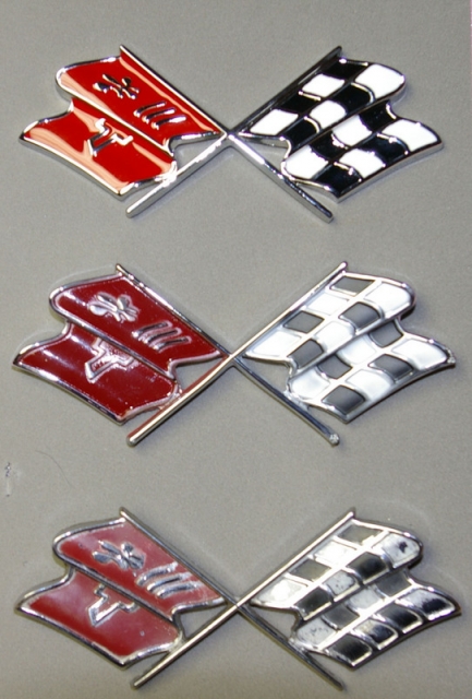

          • tom444634
            Re: Repro Die Cast Emblem quality (69)
            Kelly,
            No they were not Trim Parts. They were an off brand that I picked up on ebay just to see the quality. I have used Trim Parts Emblems for other things and they do a nice job with them
            The picture shows the repro one on the top, the currently available one from GM and my original one. One of the tell tail signs on the repro one is around the bow tie. Notice how the red floods it and it doesn't make it all the way to the center like the other two. Also the checkered area is flooded with color as opposed to painted.
            Tom
