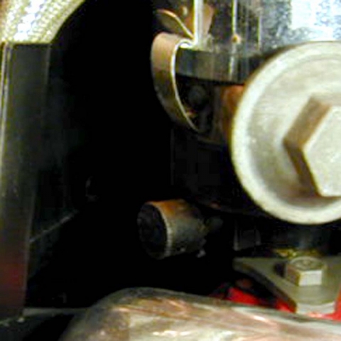

        Oil tube?
        My original has a grease cup.

          David, my engine is a passenger car 265 V8, so maybe the distributor is different. I have a tube with an L bend in it that has an oiler cap on top of it. The threaded end screws into the base of the distributor. The wick is inside the tube and runs into the distributor base to oil the shaft bushing.
