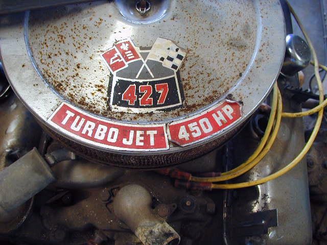

                      I have an old picture of a 450 hp on a 66. it apears to be three piece. I will attempt to post it.
                      RDR
