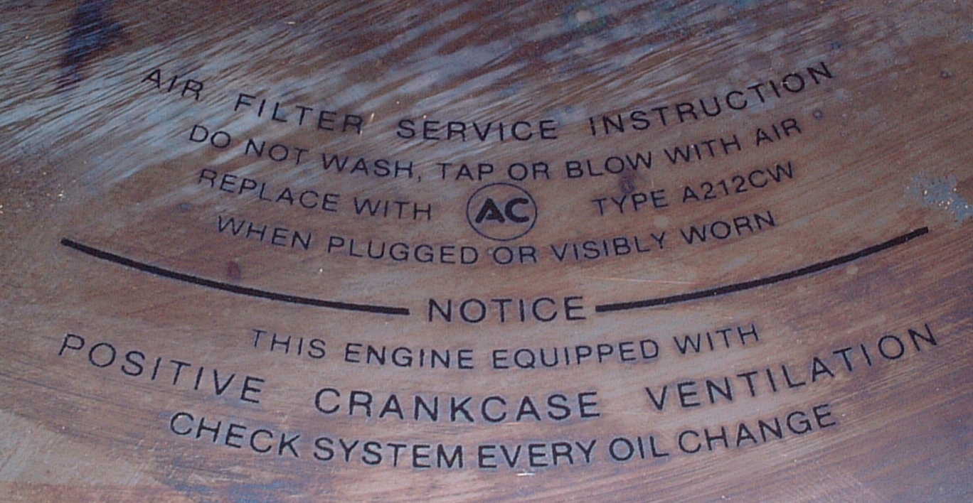

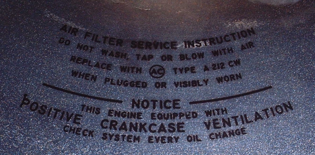

      Re: 1967 SB Air Cleaner lid original

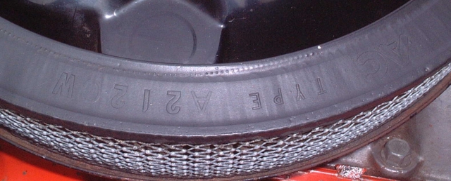

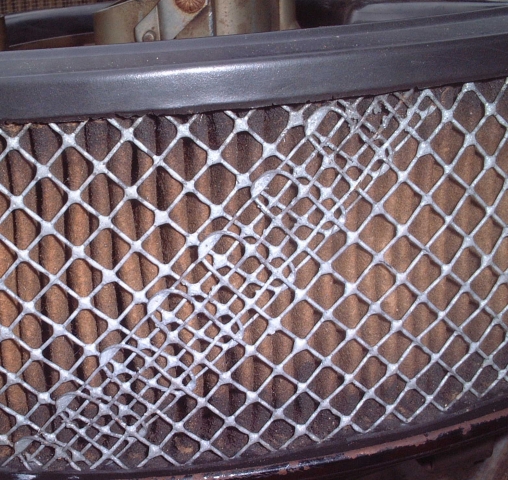

      No part numbers but note the difference in the logo on the original vs repro. lid. I'll post a pic of an original (1500 dollar and rising!) element as soon as I locate it im my files; quite different from the current repros.
      • Nick Culkowski
        Re: 1967 SB Air Cleaner lid reproduction *NM*
        • Nick Culkowski
          Re: Air Cleaner element logo *NM*
          • Nick Culkowski
            Re: Air Cleaner element side *NM*
