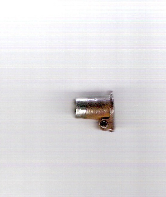

    I have a close friend he does an excellent job restoring generators, alternators etc. Does anybody have a good source for the old oilers used for the Generators. The are like metal caps that a spring loaded lid. I need several new ones...anybody got a source?

    Anyone rebuilding a generator today is using maintenance free bearings that require no oiling. As far as the press-fit oiler caps go, you can remove your originals and take them for a 'swim' in your home plating system to restore the original plated finish OR simply ask your local generator rebuilder to install fresh new ones... Most in the generator rebuild business have a supply in their small parts bin.

      Collin, I had a hard time finding them believe it or not. BUT, pillow block bearings for evaporative coolers have the spring loaded caps just like the generator, I picked up two at Home Depot foe a few bucks each, removed the olier caps and tossed the bearings. Cheaper that the vendors and no shipping fees. They look fine and work the same...

              Found a source:
              McMaster's in Ohio....look it up on the net...
              EXACT

                Should look like this
