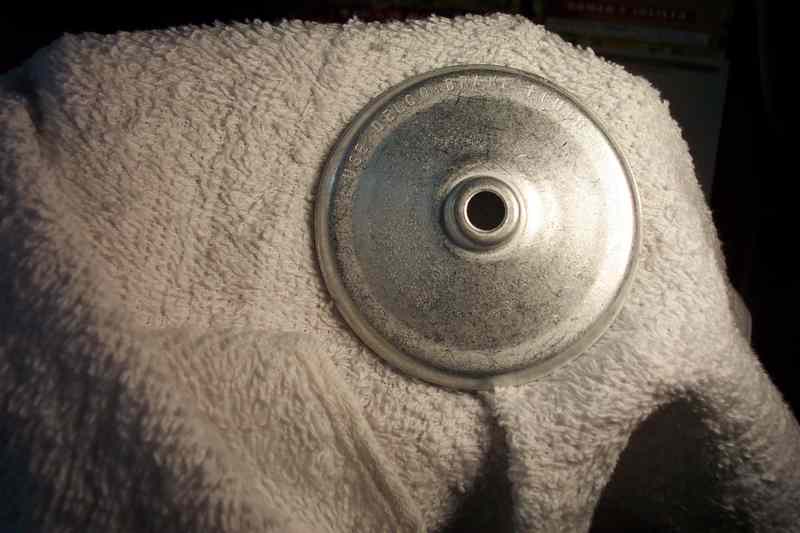

    63 Master Cylinder Cap
    I have a 63 Master Cylinder Cap. The Cap has on it 'Use Delco Brake Fluid'. It does not have on it ' Fill to 1/4 Below Rim'
    I need some help to determine if this is the real deal or not.
    Thanks
    Harry

    • Harry Sadlock
      Re: 63 Master Cylinder Cap
      John, this one has the small lettering, not sure if thats a problem. But the absence of 'fill to 1/4 beloe rim' bothers me.
      Harry

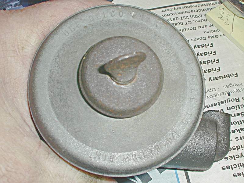

      • mike cobine
        I just looked at mine, and what I noticed is the "Fill to ..." is stamped much lighter than the rest. So much that you can barely see the "rim" with the corrosion. Maybe your cap, if you don't know the history, has been buffed and polished to get rid of the rust enough that the light lettering is not visible.

        • Harry Sadlock
          Mike, I had it under my glass that I tie flies with and there is nothing there, 'fill 1/4....' Looks to be in great shape, normal scratches, but no sign of severe rust.
          I guess the question is, did a 63 Vette have a MC cap without the 'fill 1/4...' on it. The JG says it's there. But the 63/64 is ????

                • Jack H.
                  • April 1, 1990
                  • 9906
                  There are four variations...
                  I see them ALL the time on scrap yard cars (Corvette wasn't the only vehicle to use this master cylinder cover). One has the legend extention (Fill To 1/4" Below Rim) and it comes in BOTH large and small font. The version lack the legend extention and also comes in BOTH large and small font.
                  The current '63-64 JG book defines the version with the extention as being 'correct' for '63 Corvette and is SILENT on the size of the font used to emboss. When I see the versions without the emboss extention, they're ususally installed on 1962 passenger cars, BUT, I HAVE seen several without the emboss extention on early build 1963 cars. Our JG books don't acknowledge the possibility of early '63 Corvettes having the 'short' version of the emboss...

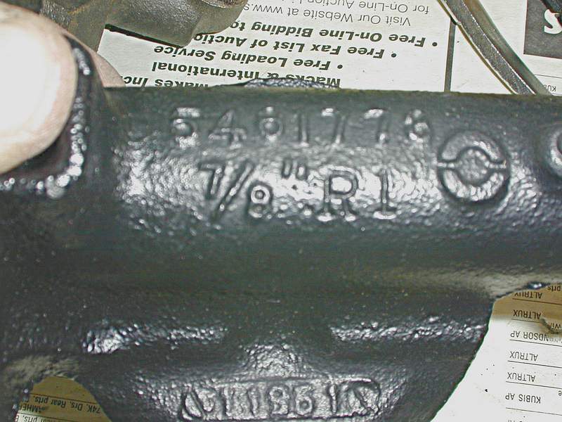

                      • Mike McKown
                        '62-'63 Corvair and Chevy II with metallic brake linings used a master cylinder with a thumb screw top that was very, very similar, if not the same as '63 Corvette including the 7/8 cast on the cylinder. If not equipped with metallic brakes, they used a very similar looking thumb screw cap with 1" bore.
                        As far as cylinder bore size, I'd have to agree with Verne. The smaller bore applies more pressure. It's difficult to get a car with metallic brakes to stop well unless they are at least warm. The smaller bore of the 7/8 cylinder vs. the 1" provides the extra boost required on cold metallic brake equipped Corvair, Chevy II and Chevelle. I don't know about full size. The smaller bore will also require a longer pedal stroke to apply pressure because the smaller cylinder doesn't displace as much fluid as the larger one but it does supply more pressure.
                        I did have the occasion to replace the small cylinder on my '63 Corvette with a 1". Same thing with my '65 Nova SS w/metallic brakes. I now have a higher pedal on both but the pedal force is much greater for the same deceleration rate with the larger cylinder installed.
                        As a matter of fact, I've often wondered if many of the C-2 owners that want to convert to power brakes haven't already had their original 7/8" master cylinder replaced with a 1" causing the higher effort.
