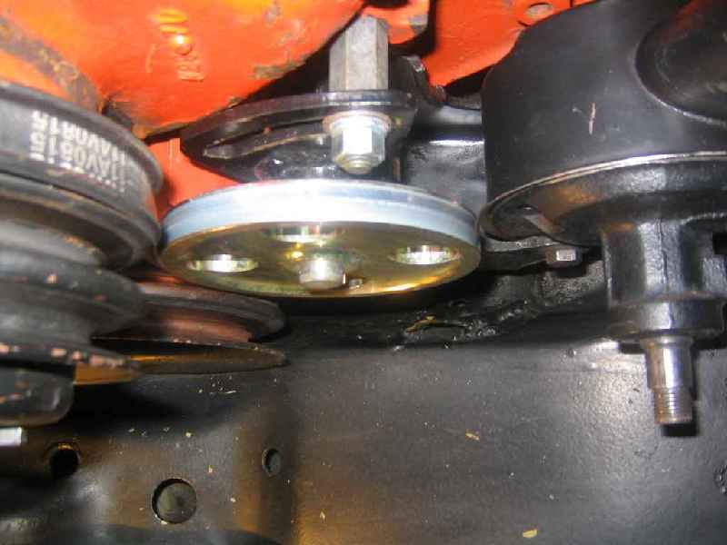

        I guess a better way to describe the pump and idler pully mounting is that they are both anchored to the same bracket. This bracket is formed to an exact fit to the PS pump. I don't see any leeway to shim or adjust the pump or bracket without similiarily affecting the idler pulley. See photo.

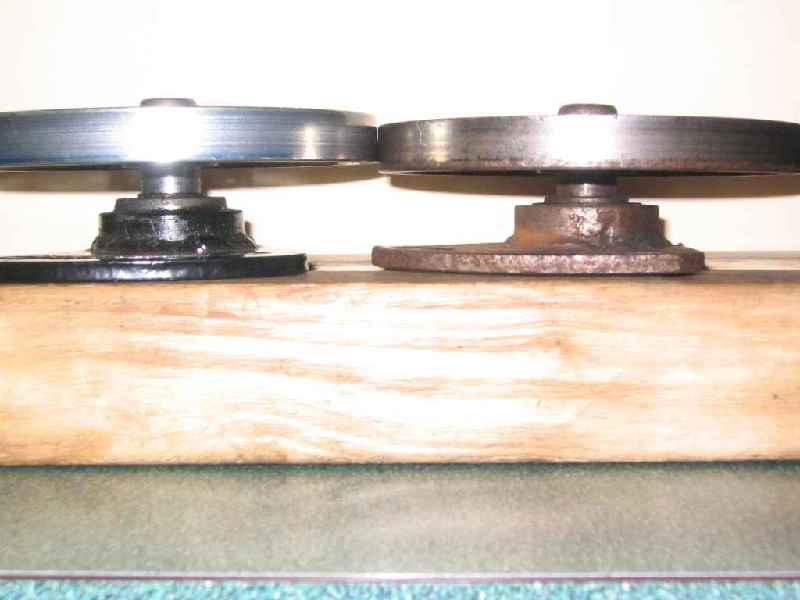

        Now, there is another factor. It seems that the new idler pulley is not pressed on to the shaft as far as the old one, which has a bad bearing. I have attached another photo below. This new pulley is the best one I could find after looking at several from two manufacturers. I don't have a press and I'm afraid to slide an impact socket over the bearing and give it a hit with a stout ball peen hammer.

          • 43229
          Re: Power Steering Pump
          Lee-----
          I think that the idler pulley spacing difference could well be the entire problem here. I'd take it to someone that has a press and press the pulley further onto the shaft to match the original. It's very simple to do this and will take only a few minutes. You're correct, though---you don't want to pound on this to make the adjustment.
            • 43229
            Addendum
            Lee------
            By the way, don't discard the original idler pulley assembly. You can rebuild it using a bearing assembly still available from GM for about 28 bucks, GM list. That bearing is GM #908076. It does require a press to do it but you could retain the rest of the original components of the assembly.
            Any machine shop could easily and, likely, inexpensively do this for you. Or, you could purchase an inexpensive arbor press from a source like Harbor Freight Tools. You can get one of these things for about 30 bucks. An arbor press is sufficient to do many automotive pressing operations----not all but many.
            In fact, if you had done this before purchasing the replacement idler pulley assembly you could probably have purchased the new GM bearing + the arbor press for less than the cost of the new idler pulley assembly. And, when it was all done, you'd still have the arbor press for the next job.

                Re: Addendum
                Joe -
                Local parts store pressed it about 1/8" ... no charge. Reinstalled. All fixed. I did save the old one. In fact the parts store practiced on this one first. I'll hang on to it. Thanks again.
