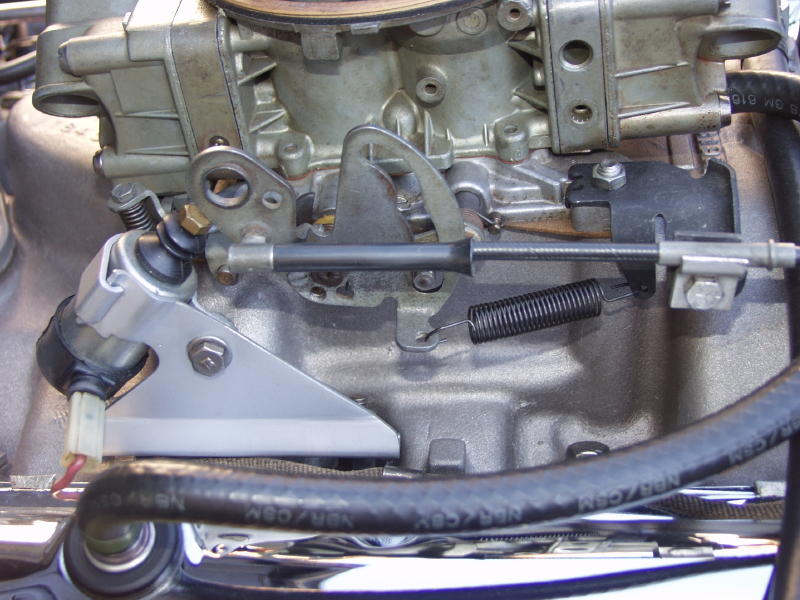

    Here's the Camaro L-78/COPO/ZL-1 anti-dieseling solenoid and bracket Mark's referring to:

          Re: 68 Carb. Idle Solenoid
          Hi Kurt,
          Here are the bracket & solenoid we've discussing.
          This is obviously a Corvette assy.

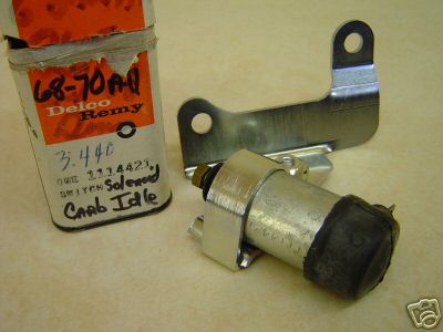

            Here's the bracket & solenoid I bought on eBay.
            Steve
                  Steve,
                  Thanks for the pictures.
                  The one you bought on e-bay is exactly like the used rusted one that is presently being auctioned off and is now at $111.00
                  I think we have determined that they were used on big blocks in 68 but not my small block. I just checked the AIM again moments ago and find only big block application.
                  Kurt
