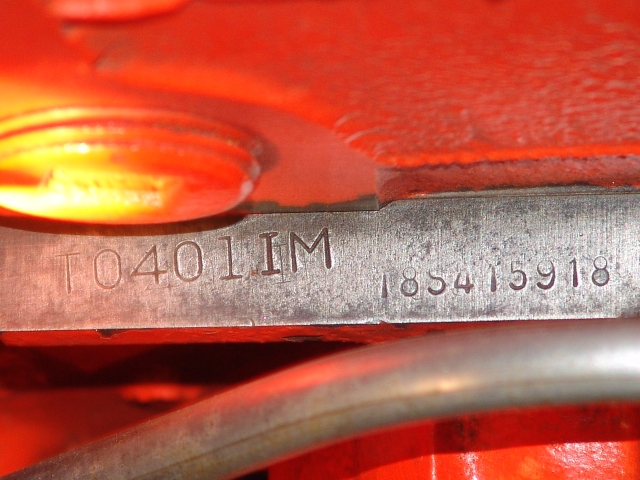

    MATCHING NUMBERS DOUBLE STAMP ???
    [/IMG]

    Johnny,
    I took it upon myself to post your pictures.
    Robert

      Re: ENGINE PAD MATCHING NUMBERS ??? HELP ??
      I would call it is a bounce on the machine code, happenend quite often.
        Was anything put on the pad to assist the person stamping, a guide, tape or grease? Thanks, Jimmy
          no. mike
            Looks like the "broach" marks are there. Al Grenning seems to be the Authority on this, and I'm no expert, but your Pad looks good to me?
              Be aware that the two sets of numbers were stamped at different times...the engine build stamp (left side of the photo) was made at engine plant in Flint, and the VIN derivative (right side of the photo) was stamped at St. Louis after the engine was selected for the car.
              As Roy said, yours appears to have a secondary bounce strike...they had to whack that gang stamp pretty hard. IMO, if the numbers were NOT the same digits like they are, and clearly on a gang like the primary strike, a second set of ghost numbers might be cause for worry.
                  If all pads were that clean it would be nice. I agree no reason to worry about that pad and great pictures.

                      0401 (April 1st) is the engine build date, if I read it correctly.
                          Thanks for all the encouragement so far, it's been really nerve wrecking..........again i never ever noticed it untill i took a close close photo.........
                          yeah motor was built APRIL FOOLS DAY !!!! 04/01
                          BIG BLOCK = TONOWANDA / NOT FLINT..........:)~
                          thanks again........JOHNNY G
                            More pictures of stamppads can be found in the stamppad database in the C3 registy (and C1 and C2 registries as well).
