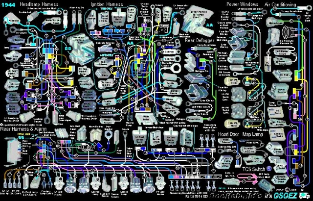

                  Re: Itz really oOSOEZ
                  Thanks Geoffrey,I knew that,
