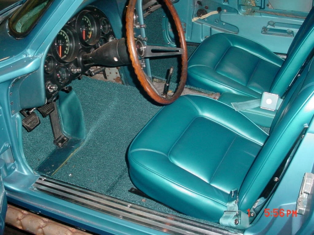

              Re: 65 dash pads
              Ken,
              Can you give us one more closeup pic of the area at the outer end of the dash panel where the panel rivets to the fiberglass? There's been a bit of confusion about how the panel tab and door jamb were painted when the interior and exterior colors of 65-67's match. Your pic clearly shows the black rivet heads and slightly different shades of blue. Thanks.

                Re: 65 dash pads
                Also take a photo of the rivet area after removal of the dash to see the finish underneath......
                How about the backside of the dash rivet "tabs" to see the paint there also....

                  mike,
                  i will get a close up on monday when i go to shop
