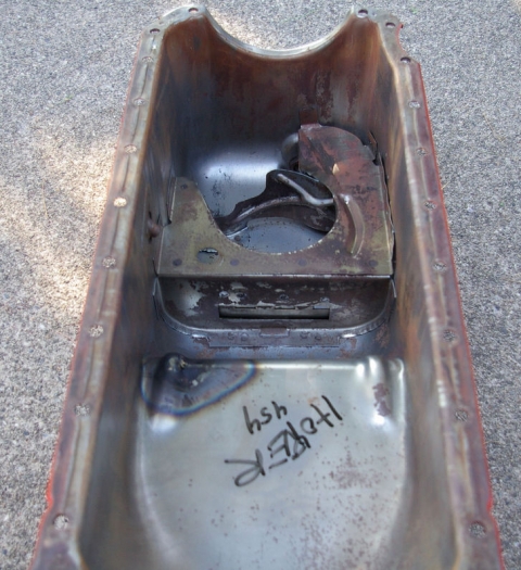

    Did all big block oil pans have the trap door as well as the baffle mounted to the main studs?
    The discoloration in the picture is from a brazing job somebody did earlier in the cars life to fix a small hole.

    Tom------
    All 1965-74 CORVETTE oil pans had the "trap door" internal baffle. All were also originally used in conjunction with an external, stud-mounted windage tray. The design of the internal baffling and the windage tray changed somewhat in 1970 to accomodate the longer stroke 454 cid engine. However, the 1970-74 pan and windage tray configuration will work fine for any 65-69. Installed on the engine, there's virtually no way to tell them apart.
