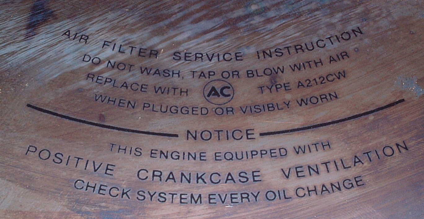

    Gary and all, these are from BB cars. Only the first is believed oriinal. How would a BB single carb lid differ from a SB lid in terms of the logo?

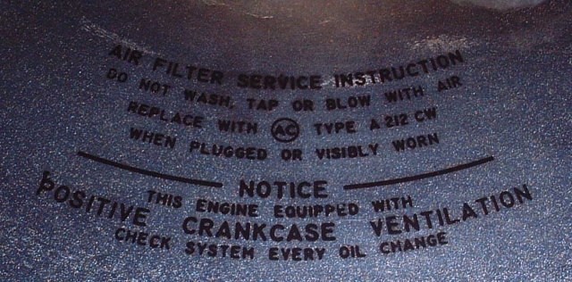

    This lid was not flash chromed...

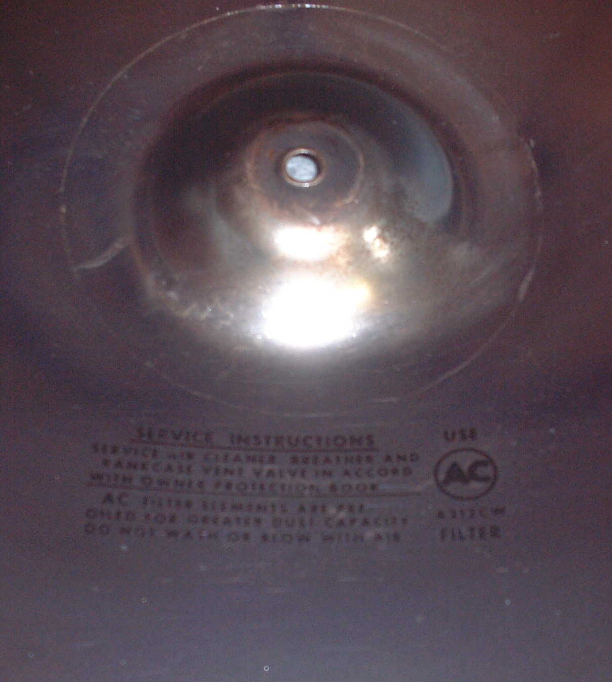

      This one was on my 66... not sure of its origin.

        I can't speak to the originality of any of these covers, although the second one you posted looks suspiciously non-original to me.
        In any event, for any given day, the covers used on small block and big block air cleaners were the same. There were no differences, at all.
