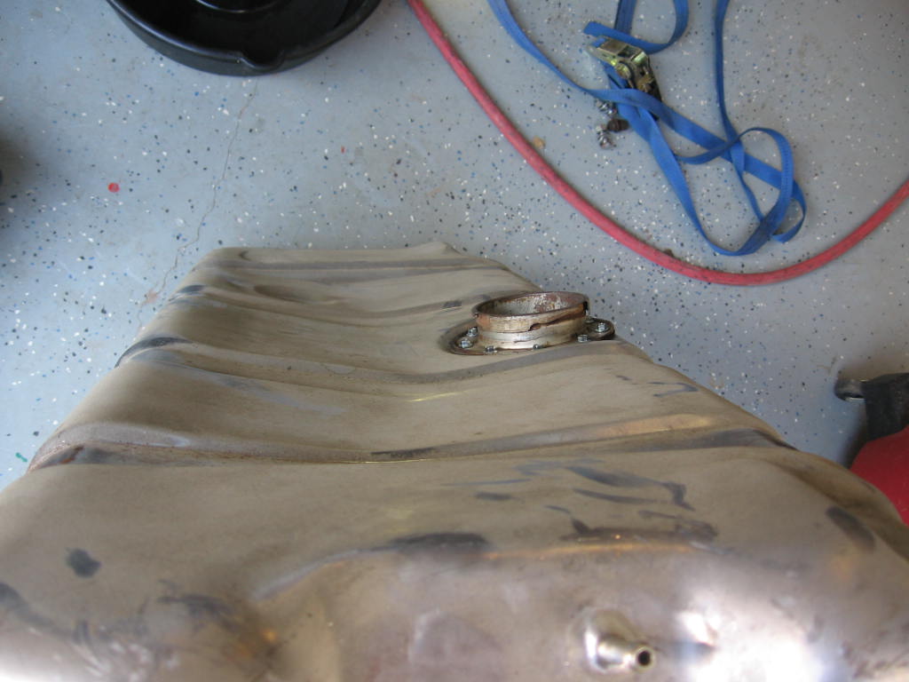

    Well, here's what a new gas tank looks like when it isn't vented. It collapses. I have a 1970 non-evap., non-vented system, with non-vented gas cap, which is correct for '70-71. I'm at a loss on why this happened, other than a bad design. I have posted on this before the tank was ruined, but it's a mystery for me. I am suspicious that they used vented caps until '69, and then again in '72 on. Did they run into this? Can any other 70 or 71 owners elaborate on their situation? Thanks

      Post a photo of the tank taken taken from the top.

              Warren - the sealed caps are non-vented. That is what's on mine. I'm wondering if your tank has a vent valve on it to keep it from pressurizing, or as in my case, collapsing? Mine has a safety valve about the size of a quarter on the top and to the left of the filler neck. According to the supplier I bought it from, the manufacturer said it is only to release built up pressure, not keep it from becoming a negative atmosphere, as what happened in my case.

                Joe - here is another pic from the top.

                  OK, from a combination of the 2 pictures that you posted I can tell you that this is the correct tank for the car. I could not be sure from just the first picture.
                  The valve that you noted which is to the left of the filler opening is a pressure/vacuum valve, notwithstanding what anyone else may have told you. It serves exactly the same function as a vented fuel cap, but allows a sealed fuel cap to be used. As a matter of fact, over 25 years ago, GM discontinued all 63-L69 fuel tanks which originally did not have this valve and replaced them with tanks WITH the valve. GM's instructions were that when an original tank was replaced with one of the SERVICE tanks with the valve, then a sealed cap was to be used. This, of course, would apply to all 1963-69 Corvettes.
                  My strong suspicion is that the pressure vacuum valve failed which caused unrelieved vacuum in the tank. That's the only thing that I can imagine would have caused a failure like this.
                  The pressure/vacuum valve cannot be replaced. Although it's conceivable that someone could unsolder and resolder a new valve (albeit a dangerous activity if not done properly), no valves like these are anywhere available as a seperate part. So, if one fails, the complete tank must be replaced.
                  An alternative would be to try to pressurize the tank to "pop out" the collapsed areas and then use a 63-69 vented style cap. To be honest, I would not even consider this alternative if it were me. Not for one second!

                        If it's new, I would return it
                        If this was a new tank you just bought, the manufacturer should make good on it and replace it for you. As Joe said, if the vent valve were functioning properly, it should be impossible to do this to the tank.

                          The supplier did send me a new tank, no charge. (it took about 45 minutes on the phone before the agreed to it). The manufacturer footed the bill, from what I was told. I too, thought that the valve was a two-way device, and not just to relieve pressure. I was told by the supplier that the manufacturer said it was only for releiving pressure. That might have been the supplier just feeding me a line...
                          I do have the new tank in, and have ordered a '69 vented-style cap, taking no chances!
                          Thanks for the responses.

                            If the manufacturer told the supplier that the valve was only for pressure relief, then the supplier should have asked them "...then what provisions are there on the tank to relieve vacuum..."? The cap used with all these tanks with the valves is a sealed cap, so it can't be that (actually, the sealed cap WILL relieve pressure at a certain point if the pressure vacuum valve fails to do so but it won't relieve vaccum).
                            The fact is that if this is not a failure of the pressure/vacuum valve, then it must be that the tank was "weak" and could not withstand "normal" build up of vaccum. It's got to be one or the other. Either way, it's a problem with the tank.
                            On the other hand, if the manufacturer is correct and the valve is only designed to relieve pressure, then they're putting the wrong valves in the tank.
