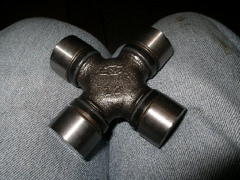

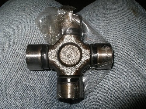

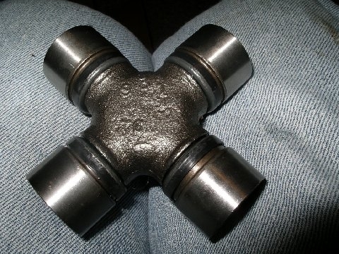

                  Joe, I have them with the bow tie on them in GM boxes [not for sale yet]. But, here is the kicker!! I bet you dollars to donuts you have them in your stash also. The shot peening process pretty much obliterates the bow tie. But, who is to say it is a bow tie or something else. What it looks like is a bow tie with an "M" in the middle of it. Maybe it means "manufactured by Chevrolet." Send me your email address and I will send you pictures of them. Depending on how heavily shot peen'd the trunion is, you can see the logo embossed. Sort of interesting. I have talked to old-tmers that said there were warrenty issues and they wanted to be able to tell the Chevrolet/GM u-joint from the Spicer u-joint. Take care, Terry tfringo@aol.com

                    The U-joints I have appear to be "lighter duty" than the new ones in your pictures. I checked mine again, as best as I could while still assembled, and they have a round recess on both sides in the middle of the trunnion. Outside the circle they all have the same bowtie with an "M" in it. Mine also have a casting number on them of 3707063 (could be 663). I noted that the bearing yoke that's welded to the end of the driveshaft also has the bowtie with the "M" and a casting number of 3742995. I was not able to locate those numbers in any of my literature. (or a part number that was one digit off).
                    Does anyone know of a supplier with a name beginning in "M" that may have sourced these parts for Chevrolet? (Melling?)
                    Verne
                      • 43221
                      Re: Opinion's on u-joint manufactures please....
                      Verne-----
                      The GM numbers that you mentioned are old forging numbers. It's very unlikley that you will find these numbers in any GM parts catalogs, either as a part number, reference or ID number. They are old numbers dating back to the early-to-mid 1950's, but they were probably used long after that time.
                      I don't know of a manufacturer that uses the symbol described. However, keep in mind that many OEM suppliers of old (and, even, today) are companies with VERY unfamilar names----very often they are OEM suppliers ONLY and do not sell parts into the aftermarket.
                      In the case of the u-joints, it's possible that the ID is for the supplier of the FORGING only---not a finished u-joint. GM may have needed to outsource some of the forging work due to capacity limitations of their only 2 forging operations of the day (i.e Tonawanda and Detroit forges). So, some other forging company may have provided SOME of the forgings to whatever GM divison was actually manufacturing the finished u-joints. GM would likley have required the manufacturer to include their ID on the forging in addition to the GM forging number (the forging dies likely belonged to GM).

                        Vern, I sent you some other pictures of u-joints. Check them out. The one's you describe as light duty sound like the main drive shaft u-joints on some C2 and C3 cars. Take care, Terry
