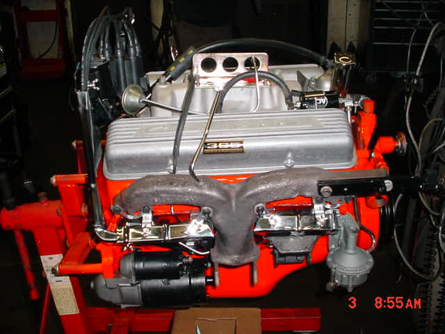

                Joe,
                Here's a pic of my 65 L79. The clean air hose runs from a fitting under the air cleaner base to the clean air tube and runs through the exhaust manifold and over to the carb choke cover. Hope that helps.
                Don Terry
                • Ken Magrene #44841
                  Re: C2 air cleaner connection
                  my l76 - same routings - clean air hose - you tube may be broken off in the exhaust manifold - when i restored my engine - i had to drill it out - li corvette has tube with hose in stock - it comes out the bottom of where the choke tube is - choke tube out of top - clean air tube out of bottom - see pic
