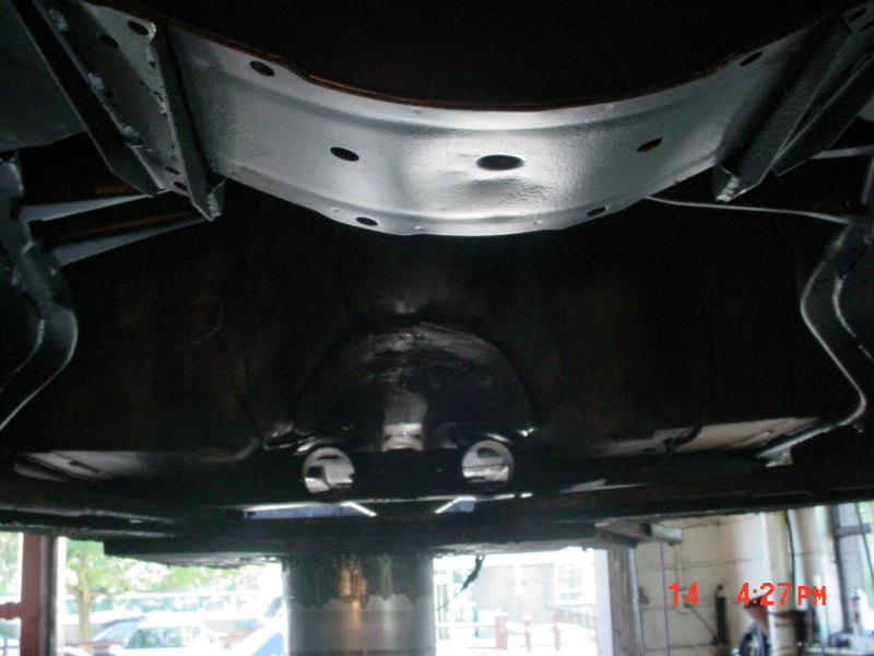

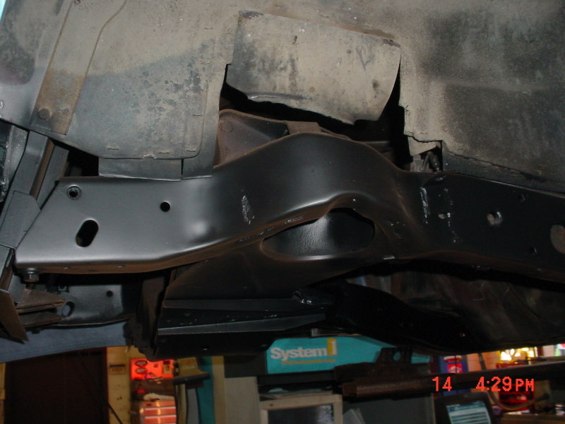

    i am currently repainting my frame - i was told to use krylon 1613 semifalt black by a corvette resoration shop - is this close to factory or is there something better - also what can i use to clean under body & wheel wells - from what i have seen - should be bare - no paint? -

        Ken,
        It was originally painted with asphalt based paint. It can be obtained from Quanta (see link).
        Interestingly, you can still see your job number in the pic. Looks like 379 or 329. That's something I would want to preserve.
        Don
        • Stephen L.
          • May 31, 1984
          • 3158
          Re: 65 body on - paint pic again

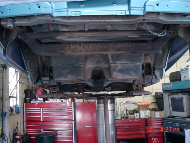

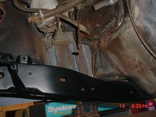

          The wheel wells had some blackout areas and sound deadener (undercoating). Check out you AIM for covered areas. If you clean the dirt off you'll see the spray areas for each.
          The floors etc were bare. The firewall down to the sloped floorboards was blacked out. Again, clean with soap and water and you'll find the paint lines.
          Your photos show unmolested areas so I'd think that you have some good documentable paint areas to guide you....
          Photo the areas after washing and before you strip anything so that you have a record to go back too.....
          I used Eastwoods Chassis black on my frame which is close to the Krylon.. possibly a little more shine.
          It appears you are only a few bolts away from a body-off which would make cleaning/detailing a LOT easier. Go for it!!!! You'll be happy you did.

            more pics - before and after krylon 1613
