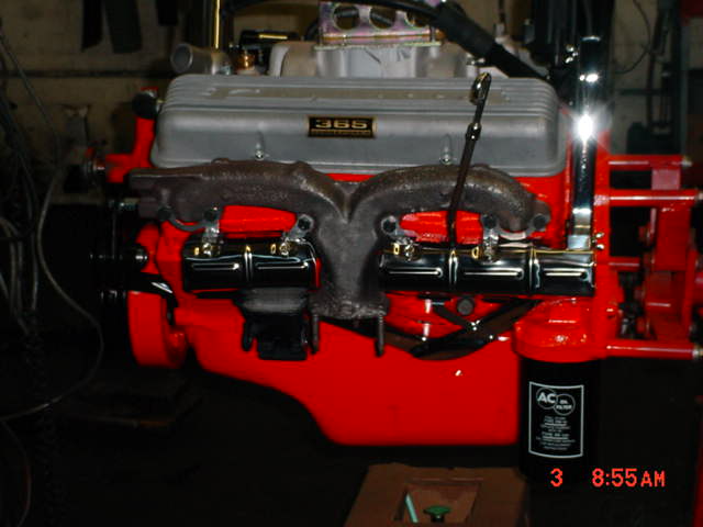

        • Ken Magrene #44841
          Re: 65 365 hp oil pan
          mine comes out rear - nos pan - you can also tell the difference - pan sump is huge - sounds like a regular chevy pan on there. see pic - notice how big the sump is 6qt
