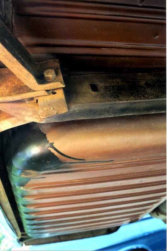

    Here is a pic..
    Gene...not at all sure if this is original but it is a photo for some more knowledgable types to comment from....1965 2.5 inch exhaust..

      Nothing was "mitted", but that's another story by itself. If you look at the photos on page 318 of Noland's book, you'll see the muffler blackout; it was sprayed from the side in a canvas-walled booth at the very end of the Chassis Line, just before Body Drop, so the side of the muffler visible in the rear wheel opening behind the tire appeared black.

        Re: Here is a pic..
        John,
        This is a passenger rear blackout ('63 St. Louis). I don't see any evidence of spray. Perhaps the two lines operated differently in that regard.
        Verne
          Re: Here is a pic..
          Yup, different plants, different products, different requirements; but there was no "mitting" in either plant - it was sprayed.
