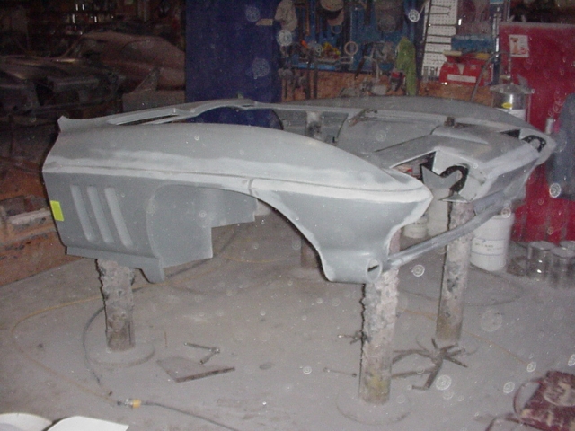

        Wayne Womble just posted this picture on another thread.
        You can see the seams in the front end. If you have wrinkles or lines at other places, then it has been cut or patched or something.
        From what you describe, it sounds like someone cut a front end off at the wrong place and patched a new one on.
        I've been amazed at the number of people who cut at the back of the clip and patch, rather than take off the old cowl fiberglass under the windshield.
        Sure it is harder, but the right way usually is if you want the results to be the best.
