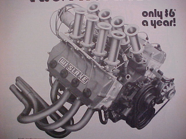

      This is the "photo" I was talking about. It is from an ad selling subscriptions to Hot Rod magazine that was published on page 15 of the August, 1975 issue. The subscription ad doesn't mention the image at all. For all I know this could be a cut-n-paste job that was meant to be some kind of joke.
      This image has obviously been retouched quite heavily. It is proof of nothing.
