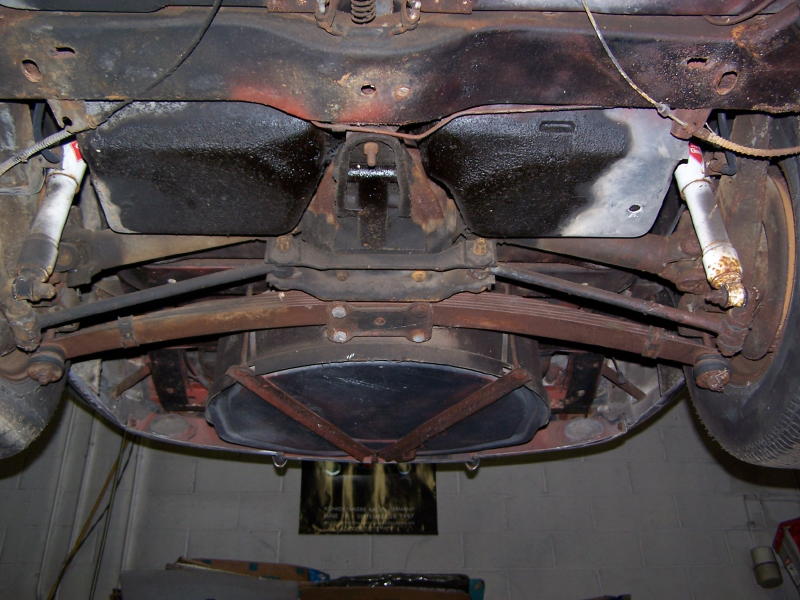

          The car also has side exhaust but I don't know if they are factory. Here is a photo of the back filler panel. It looks like it has been patched? Yes? or does this look like a correct filler panel for side exhaust.
          Thanks again,
          Mike

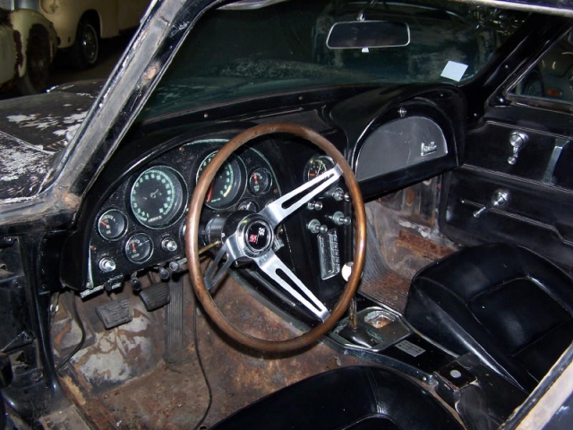

              This is all I have for now. I'll try to get more info. I know its not a close up but what can you make of this? If anything.
              Mike

                I would say that is a tach for a big block are a 375hp FI?
                • lyndon sharpton
                  Re: 1965 HP??
                  that must be a 6500 redline?

                    Yup, could also be a tach for a 365 HP 327.

                      Owner said the yellow starts at 6200 and goes to 6500, Red from 6500 to 7000.

                        here is a redline synopsis for the C2s (SB and BB) that I have gathered:
                        63-66 327 - 250/300 - 5300
                        63-65 327 - 340/360/365/375 -6500
                        65-67 327 - 350 - 6000 (early L79s may have 5300)
                        65 396 - 425 - 6500
                        66 427 - 390 - 5500
                        67 427 - 390/400 - 6000
                        427 - 425/435 - 6500
                        and then you've got your oil pressure guage, etc. If you are really on the hunt for "tells" that aren't normally changed, get a look at the two-letter code on the back of the cluster (you should be able to spot it with your head up in there and a flashlight, perhaps use a mirror) - I once tried to assmeble a complete listing of the two letter codes found on C2 clusters and what they implied, but never completed my little project.

                          As far as the sidepipes, the picture doesn't show any telltale areas. The rear valence does look like it has the exhaust holes filled in.......but tht's waaaaaaaayyy too easy. There's a lot more to it than that. What is the serial number of the car? Is it a St. Louis or Smith body?

                            The tach indicates it is either a 365 HP or a 375 HP (fuelie). Assuming the tach is original, which it looks like it may very well be. Given the rarity of the FI, it is highly likely a 365 HP car. The easiest clue would be to see if it has the crossed flag emblem on the fender. If it has the FI badge and no flags, then you would need to do more detective work under the hood. Good luck!
