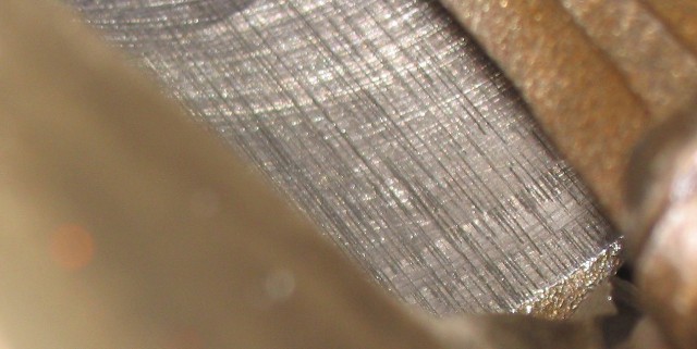

    After owning it for 2 years and only changing the oil twice (I've driven it just 2000 miles total), I finally got around to dropping the oil pan to fix a leaking rear main seal. That's when I made a very disappointing discovery: judging from what can be seen looking at the lower half of the rear main bearing, oil pump gears and cylinder walls, there's significant debris related damage.....felt with a fingernail. Two cam lobes out of maybe 7 or 8 that I

      Bill - From what little that's visible from below, there IS significant evidence of debris damage to the cylinder walls. I can see #'s 7 and 8 which are near TDC. There are numerous 'score marks' parallel to the bore C/L; running from the bottom of the bore and disappearing under the piston skirts. They appear deep enough to be felt with a fingernail, but I can't contort my hand enough to actually feel them. As you indicated, I'll know more after disassembly. After 24,000 miles since the last rebuild, the 'scoring' is MUCH more visible (and deeper) than the cross hatching.

              I'm attaching a macro photo I took of the scoring. It runs from the lower right to top left (parallel to the bore C/L. Note the connecting rod is visible to the right of the wall scoring.
