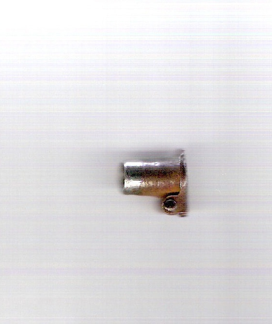

            The 1938356 "oiler", as it is called in my early parts books, is the cap that presses into the outside body of the distributor for external oiling. I've attached a picture. It appears to be the same part as used on many generators. The passageway from it to the top of the main shaft had some other gummy residue in it, which I believe was either felt, cotton or some other material used to "wick" the oil onto the shaft. I guess it was kinda like a small diameter cigarette filter. I doubt it's available anywhere either.
            I was not referring to the Wick, p/n 1931748. I probably shouldn't have said "C2" because this distributor is a '62, #1111006. It is a single point, vac adv dist. It was released as part of a service package sometime in Feb. '62. It is not a Corvette distributor.
            The felt washer I removed was saturated with oil. There was no source of oil leading to it, and there was a small hole through the bottom of the distributor casting under it to the outside. That lead me to think it was acting as a filter to allow fresh air inside the distributor to relieve the ozone created by the constant sparking. It has an OD of ~1.100"
            The 1932024 "retainer" as it is called in the early parts books, looks pretty much like a thin wave washer, but cut, (like a wavy piston ring). It would be great to find a source for new ones, rather than having to resort to parting out old distributors.
            Was there something in the recess at the center of the breaker plate, where the cam rides in that lubricates the bottom of the cam as it rotates? I'd think I'd need something there so the cam doesn't rotate against the metal base of the breaker plate. I don't believe there was anything there when I disassembled this one. The inside dimension of that cavity is ~1.050".
            My local NAPA dealer closed down recently, but I believe I have access to Standard brand parts. I'd really like to put this back together again as good as new (or better). It has minimal wear. No bushings, just metal to metal, and the only measurable wear is at the bottom. The shaft is 0.001" smaller diameter there. No upper wear. (maybe the rear camshaft bearing was worn out)
            Thanks again
            Verne
