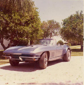

              There is a web site that has a lot of info on this car.
              I ran into this site a few years ago. In one article, it tells that Gus Grissom had the fenders flared and mags added. I think one said he had it repainted. Anyway, once repainted, the color of the stripe is meaningless. I'd have painted it white, too, to match a white top.
              Super Chevy Magazine 08/1987
              • mike cobine
                Here is the blue car
                Here is the car with flared rear fenders and blue paint.
                Here's the link to the photos.
                Blue period pictures
