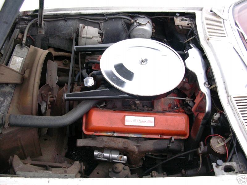

                • mike cobine
                  Re: I'm too stupid - posting pictures
                  Jerry, one of the easiest ways I've found to post pictures is tinypic.com.
                  1. Have your picture on your computer.
                  2. Go to http://tinypic.com
                  3. Click the "Browse" button to find your picture.
                  4. Click "Open"
                  5. Click "Upload Image"
                  6. For the NCRS board, go to "Link" and copy everything in that box. It should start "http:/"
                  7. Paste it in the box next to "Optional Image URL that is below the Message box.
                  In this case, I found a '63 #20038 and I think it is unrestored. So it may help with the shock washer. Then again, it may have been changed 30 years ago before it went into hiding in a barn.
