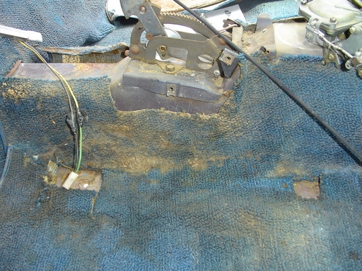

      Alan,
      Here is a shot of my 67 coupe carpets. You are looking in the driver's door at the ebrake on the middle of tranny hump. These carpets are the originals as you can see the "J. P. Stevens" tag glued under a piece that is rolled back on the passenger side of the tranny hump.
      The front does have the flap cut out partially and the back lays on top on carpet but has a small cutout for the rear bolt.
      Justin #41362

        Ooops, meant passenger. *NM*
