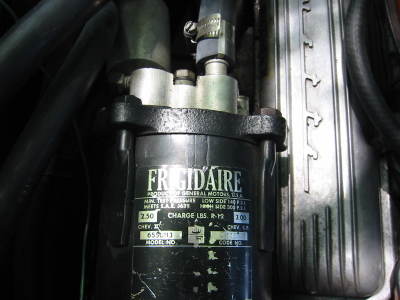

      Frank, Are the date and ID# located on the rear plate of your A-6? If so can I get a photo as I am cataloging A/C systems on Mid Year cars. Thanks, al w.

        I will send the pic tomorrow. I just tried to take it and the light is bad.
        Do you need any other info?
        Frank

            Alan, Here's the photo you asked for.
            Frank
