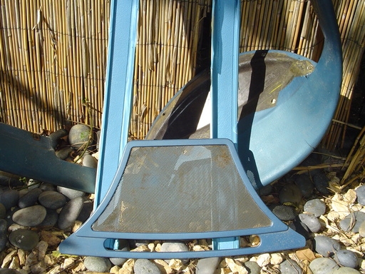

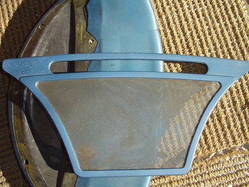

    Joe,
    My 67 #450 interior is the same color combo as yours. My dash, Pads, speaker cover, and console are all the same blue. They are all original and untouched from the assembly line.
    I tried one of the spray cans from a commmon vender to touch up and it was WAY off! The blue was more of an aqua/green color and I haulted all resto work there.
