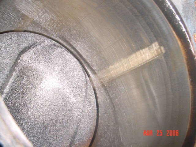

    I currently have my engine out of the car. My original intent was to freshen it up w/ some new gaskets, paint & also do some underhood detailing. I pulled the heads and found some strange "scratches" on the #3 cylinder (they feel rough to the touch). I've never seen the inside of an engine before, so I'm not sure if this is normal. My compression checked out OK back when I tested it in Dec 2003 (less tha 1k miles since then). I checked it when the engine was cold and got readings of 142, 120, 143, 150. I have a thread at the CF with pics.

    Can anybody explain those scratches?

    please post pics of scratches *NM*

      pics here
      Here is a close up on one of the "scratches". There are a total of 3 like it on the cylinder walls.

        As best as I can tell from the pictures, I would say thet these scratches are the result of some sort of ring problem. You will need to remove the pistons to more fully inspect for this. Most likley, if the scratches will not clean up with a light honing (a good machinest will know), you'll need to overbore.

          In this case, the pistons were definitely replaced with the 69 or 70 pistons. Most likely, someone did this to get the higher compression used in those years. The 72 pistons were a flat-top with one elongated notch for valve clearance. Obviously, these pistons are the 69-70 domed style LT-1 pistons.
          It could also be that the "someone" that did this somehow screwed up the piston ring installation in a few cylinders.

            Minor scoring, which should not be a problem for a "driver" or even a restored car if you are not after internal engine perfection.

            You should always run compression or leakdown tests with the engine hot. Your numbers have more that the factory specified 20 psi variation, but a hot test might prove otherwise. The bore with the minor scoring reads the lowest at 120, but it might read better on a hot test.
            This is a situation that could go either way. If engine performance is okay, and you don't drive the car a lot, the engine could be okay for many years to come, but if you are a perfectionist, now may be the time to rebuild the engine.
            Another thing you could do is measure bore wear at the top of the cylinders, If it is no more than .003" the engine still has some life left in it.

              some time these scratches show up when using "file fit" rings if you do not use a fine honing stone to "break" the sharp edges on the "filed" ends of the ring after "filing" them to get the correct "end gap"
