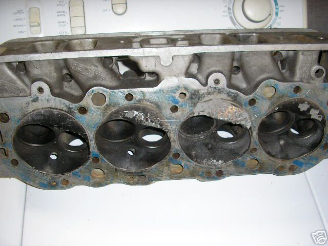

                        The 842 heads were only cast with a closed chamber. Any that you see with an open chamber were a hot rod modification (the open chamber heads did not shroud the valves as much and breathed better).
                        Probably more 1969 L88's were built with the 842 than the 074 heads as the change over occurred after the strike ended. That was also the change over for the 4054 vs. 4296 carb.

                              Here is an '074 aluminum head that shows a somewhat open combustion
                              chamber design.
