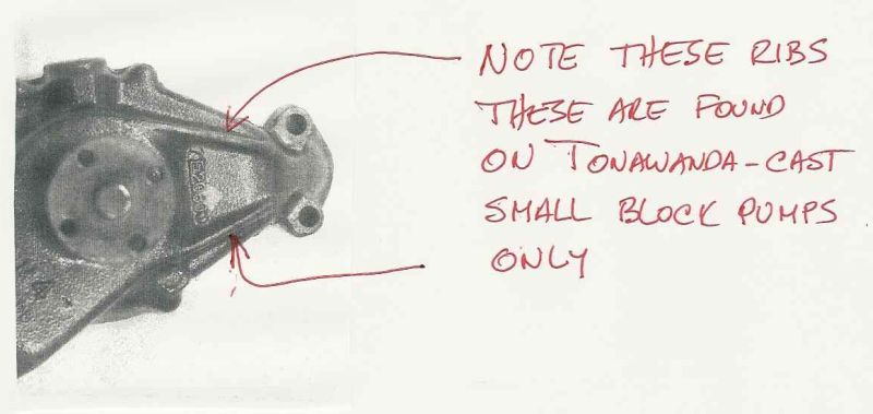

        Yes, I missed that. Even though the dates might not be visible, many Tonawanda-cast '608' pumps have a different configuration than Saginaw-cast. They have 2 reinforcing ribs on the driver's side of the pump body. While the dates may not be easily discerned, these ribs are.
          • 43221
          Re: Is this correct C2 Water pump GM# 3762608
          Here is a rather poor photo but I think it will show the Tonawanda small block pump configuration I was speaking of. Saginaw cast pumps, which were used for all Corvette small blocks, did not have these ribs; the casting was "smooth" in this area. Functionally, the Tonawanda-cast pumps are stronger and, consequently, better. They're just not correct for Corvettes. You'll need to scroll down a bit on the "white" to see the photo.

              • Robert Wingerter
                This water pump is smooth - it does not have the ridges like in the photo. I'll try to get a picture.
