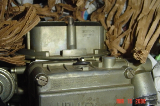

    Dear Members,
    I have a 'Service Replacement' 3810 for my 67 327 coupe. My car is an early Dec. 19th 1966 built car, but the carb says "221" for a date.
    How many points are awarded for a correct carb out of 4500? How many will I get smacked for the wrong date? It is a total of 4500, right?

    Re: 3810 Holley Judged Points
    Justin,
    Nice to see you back on the forum, where have you been. The total points on the carb are 40 on originality and 20 on condition,total 60. Your carb by the date code is a 72 replacement (you sure it isn't 721). It looks nice with the slotted fuel bowl screws. I'm not a judge, but I think that the judges would be light on the deduction considering the vintage and condition.
      Hi, I had my 1967 390 car judged with a 1969 service replacement 3811. The carburetor was correct in every way but the date and I lost 10% for originality and got zero deductions for condition. That translates to 4 points from 60 for the carb and 4 points from 4500 for the car. So if you have a correct service replacement you have nothing to worry about. The lost points are not worth the 100's of $$$ it would cost and the time it would take to get the exact 3810. The judges will be happy that you didn't get a new repro, which carry a 30 to 50% originality deduction. Hope this helps you.

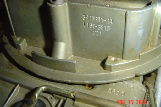

              Hey Jerry!
              I just took another look and it says: 3906631-DA
              LIST-3810
              221
              The front meter block says: 4743
              3810
              There is a plastic white piece on the passenger side (41R539), not quite sure about what it does? Are these still available, mine is a blackish-green color. Besides that, it looks pretty clean and the plating is continuous around all sides.

                  White Plastic Piece
                  Justin,
                  I don't have the Holley book in front of me for the part number, but I think the white plastic piece is the fast idle cam. See picture:
                  (sorry to keep reposting this pic, I'm really proud of it)
                  The other white plastic piece is like an oblong washer around the choke rod.
                  Both of these parts will probably clean up nicely by soaking in lacquer thinner.
                  Some of the fast idle cams were green.
                  Any of those small parts are available. I got most of my small parts, replacement screws, and a fast idle cam, from the carbguy on ebay via email. Great guy to deal with. I think you were in touch with him last year on the fuel bowls.
                  Looks like you got a good deal on your carb. It has the original look unlike later replacements. It probably has slotted screw heads in places where the later replacements have phillips.
