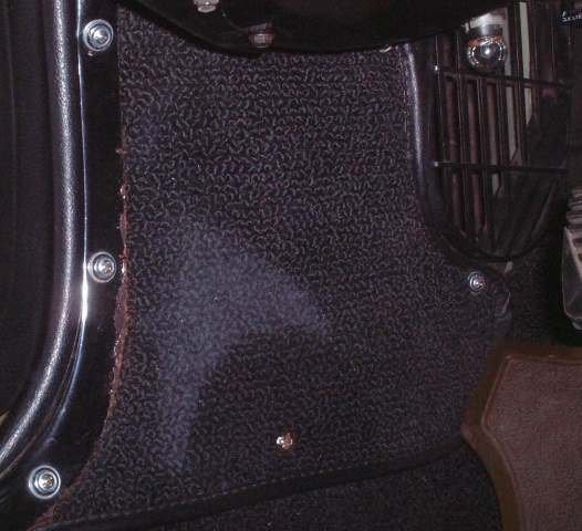

            Re: C2 66 Kick Panels
            Hi Steve
            The three screws on the windlace are correct with the integrel washers.
            The two in the middle (top and bottom) should be the counter-sunk trim screws with the accomanying conical washer that has the tangs that crimp onto the backside of the carpet. Similar principle to the "Thumbhole" bezel in your jackboard cover. The front screw should be the same according to the AIM's. However, on many original '66 and '67 cars. That forward screw is that "Windlace" type.
              These are on 67 #17214, believed original

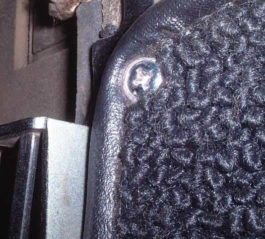

              • Nick Culkowski
                Another view, left side '67 #17214
                • Mike M.
                  Director Region V
                  • August 31, 1994
                  • 1463
                  Thanks, Nick, One picture-worth a thousand words. *NM*
                    Just a point of clarification of the "Kick Pad" and "Halo" screws being the same. As John said, they are, but, the two washers are not the same, each is unique to the specific application.
