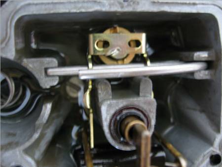

                  I re-measured the float again, and it "appeared" to be slightly off. It's supposed to be 3/16" for my engine and it was a little less than that. I will wait and see if that does the trick - it usually takes a day or two before this leaking appears. I checked the choke pull-off diaphram. I removed the hose, pushed it in all the way and then put my finger over it. It backed out about 1/8" but stayed there; it didn't travel any further. When it's running cold, it stays in all the way. Here'a a pic of the needle clip position. I think I have it right. Mark

                    Yes, your needle pull clip is correctly installed. And one more question, when measuring the float level you are measuring it 3/16" back from the nose of the float. This is properly shown in most rebuild kits. A lot of the early replacement floats had a raised line cast on the float to denote where to measure float depth, but I haven't seen this in awhile.
