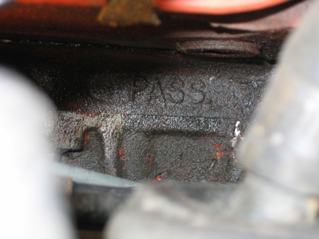

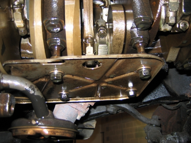

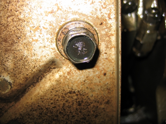

            I have never seen an original 961 in a Corvette.That doesnt mean it cant be. A few questions please .Does it have the ribs on the front and back of the block?. Behind the rt head is it cast Hi per or pass.What type of bolts/nuts held the windage tray to the mains.What codes are stamped on the rear end assy.Whats the starter & carb #? If you pull the body I would like to see photos of the rear underside bulkhead,,,,Thanks Bill

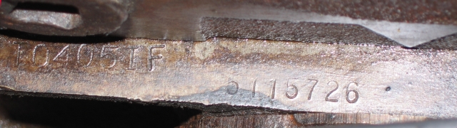

              Don't you think the "5" in the number sequence looked a bit odd? In a non original way.
              • Michael H.
                • January 29, 2008
                • 7477
                #37
                Re: Engine identification
                Gary,
                I agree, there are some very strange things on the ID pad. The VIN characters almost appear to have been stamped with two different tools/holders, or two different strikes. The 511 group is on one angle and the remaining four characters are on a different angle.
                The "F" in the Tonawanda group is interesting also. It's common for VERY early 396's to have hand stamped engine suffix characters but this isn't what I would consider a very early 396. I suppose anything is possible in the first weeks of big block producton but the VIN stamp wouldn't have had anything to do with Tonawanda since that pack was installed at the St Louis plant. I dunno.

                  If you are referring to engine stamp, no, it is a factory stamped engine as per my comparisons and those of the BG senior stamp manager to known original stamps.

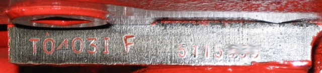

                    Here is another "real" stamp for comparison. Superimposed, they are IDENTICAL. Again car was passed as a SURVIVOR in 01 in ALL categories.

                      Would it be possible to post a larger pic of the number pad from the survivor car?
                      I agree on the wacky Tonawanda characters, as seen on the #15726 car. My very early 396, #14971, had the suffix characters hand stamped and they weren't even close to being in a straight row. Not sure how long that process continued in production at Tonawanda though but quite possible it was still happening when #15726 went through.
                      I definitely try not to judge stamp characters at all now, and especially on a computer screen, but the VIN package certainly wouldn't be typical. Not saying it's incorrect, or fake, just definitely not typical.

                        What ribs are you referring to? I have an image of the windage tray bolts. I will photograph and post these images for viewing shortly.

                          Here are the bolts. E marking grade five

                            The casting behind the passenger side cylinder head shows "PASS".

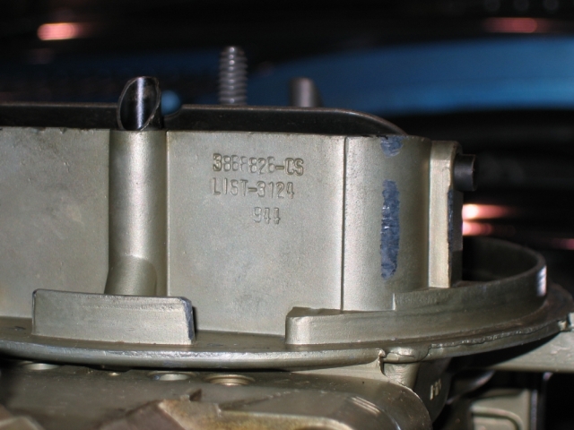

                                Here is the carb.
