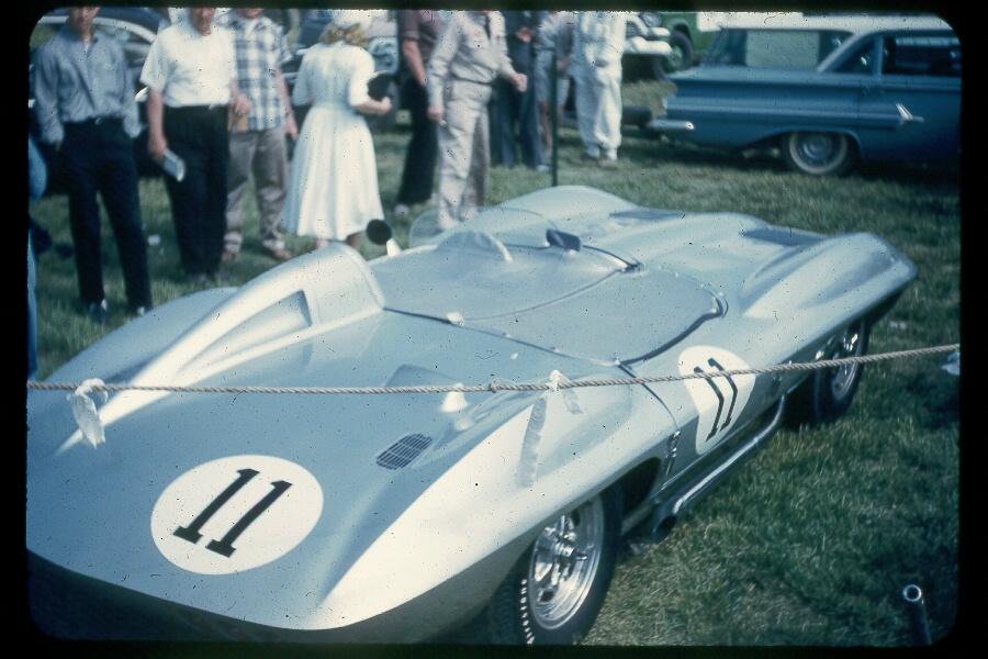

                            Growth of tire sizes on the street didn't begin until close to then, but in racing, they began much earlier.
                            In this picture of the Stingray, you see the fenders allowed for a lot of tire room. I'm not sure, but it looks like a 5" Halibrand on front and a 6" on rear.
                            If you make a trip to Darlington to their museum, you will find very large and fat tires on some very old cars.
                            While building the Grand Sports in 1962, they changed the fender to include much large tires. However, by 1964, even that wasn't enough and they had to install flares as shown in these 1964 Sebring pictures.
                            Many sports car racers clung to the idea that a skinny tire gave better performance, but then, sports car drivers clung to a lot of strange ideas that NASCAR and engineers were disproving and going in the opposite way to speed.
