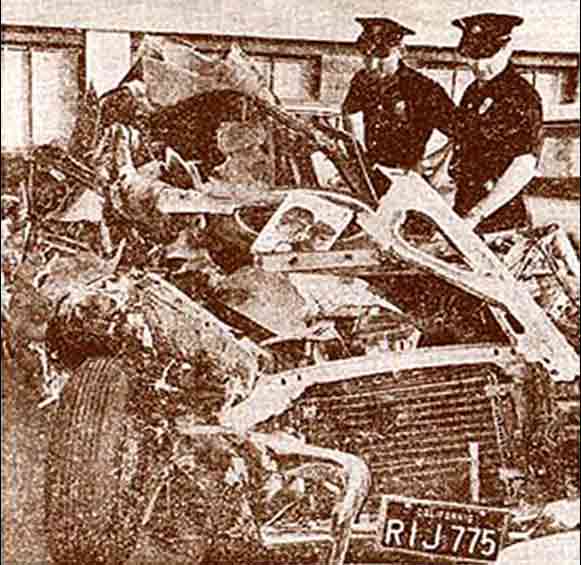

    On the registry site I viewed Jan Berry's smashed corvette after his April 12th 1966 crash it's a wonder he survived at all after such a terrible accident. Any body have any info on his corvette was it a 1966 427?

          Judging from that wreck photo...
          ...it appears to be a '66 coupe with a 390hp 427 and factory air.

            is that a 33 1/3 laying on the air cleaner? are there any better photos of the car? this is the only one i've ever seen.

              From the picture it had AC and was definitely not a 65.

                Also not a BB because of the cross brace on the hood under frame. And that looks like a wheel and tire laying where the air cleaner should be.

                  I think it is a big block. Looks like what remains of the hood support on the drivers side, still attached to what's left of the x brace. Small block support would have been on the pass side. The 66 big block hood did have the x brace.

                    Yes maybe, I agree that the 66 BB had the cross brace, the 67 did not. But brace is shaped differently and it is hard to tell from the twisted damage which one it is. But, a 66 BB AC car would have had bolts with large washers at the upper ends of the radiator support. Again it is a bad picture, but I dont see the bolts and washers.

                      The core support is definitely big block, due to the pairs of holes/bolts near each end of the upper bar and the slight arch to the center. The small block didn't have either.
                      Definitely AC, as you can see the condenser. I seriously doubt a pop star would have it added at a local garage so it was ordered and thus factory.
                      390 hp 396 with AC? Nah, even Barrett Jackson hasn't seen one of those, so that leaves '66 390 hp 427 with AC.
                      The crash was too early to have a '67 unlike the movie.

                        If you look at the corners, you see two dark spots that are the bolts. The piece of hood support like Michael said does have the hood support brace there on the driver's side. There are no bolts in the center of the support top bar.
                        The small block support in this picture shows no holes/bolts on the ends and a sharp 90 degree corner to the opening at top, not an angle like in the picture.

                            I agree Wayne, it appears there are no bolts/washers or upper radiator brackets in the pic. It's definitely a big block core support though. Possible it's an early production car and the large washers/spacers weren't used and what we are seeing is actually just the bolt heads?
