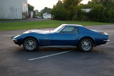

              The mileage is accurate though. Bought the car from the 2nd owner who had it for 20 years. Nobody has been in the engine...yet and it runs well. It is complete to the point that the only thing I can find that is not original is the alternator and possibly the starter which has a small block part number on it (discussed in a previous thread) but that too could be original to the car. All of the gauges work and the interior is in great shape with the exception of a small (1") wear mark on the drivers seat and a hole that somebody drilled in the shifter plate.
              I have had many cars over the years and done a few restorations mostly on Chevelles and Camaros. This is my firat Corvette. I've always wanted one since I was a kid and it took me almost 9 months to find an "unmolested" big block that I could afford. Got this one back in the end of September.
