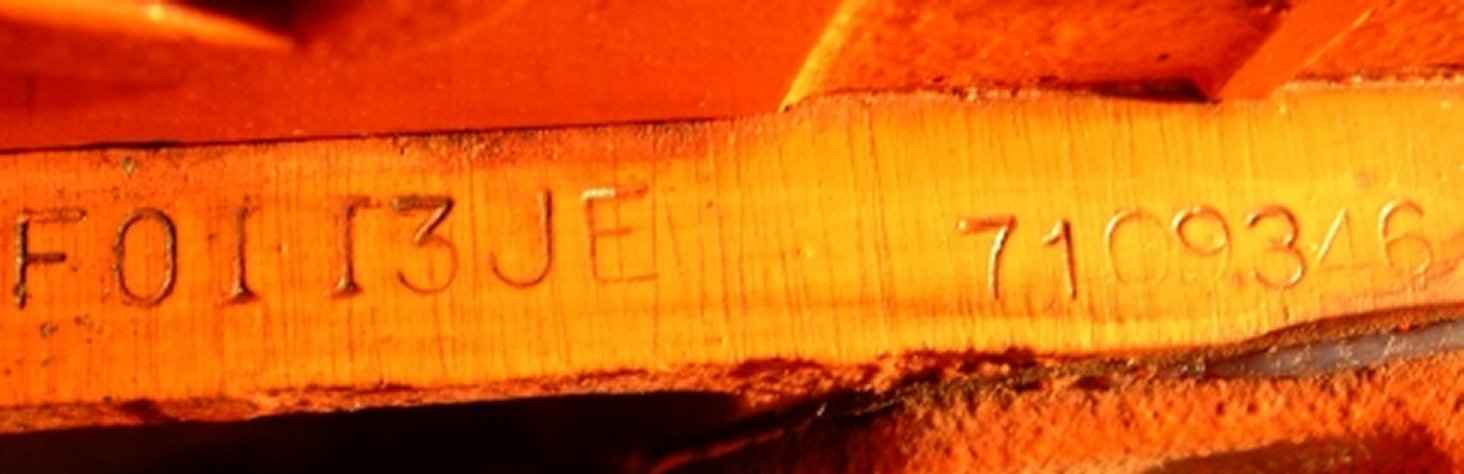

    I have very few judging points compared with most of you all,but I'd say FULL DEDUCT!

        Weren't all big blocks built in Fonawanda? Broach looks great too. I think the grain is supposed to be on all different angles, like a cross hatch, right?

            Re: Broach marks e bay Your opinion
            The F should be a T

              Note VIN stamp wasn't ganged... *NM*

                Re: Fonawanda
                ------Im sorry but the superlatives that are brought out in the description of the car I see in the pics make me wonder if the owner put up pics of the wrong car or something.........Bill S

                    "Numbers guaranteed factory original."
                        Didn't even get the paint on the hood correctly, all replacement carbs, a real "original", why even look at the engine given this degree of attention to detail?

                          Re: Fonawanda
                          ROFL
                          This is a great example of someone not knowing a thing about what he is doing. Stamp a Corvette big block with an "F"? LOL
                              Blowing the photo up shows a lot more - at least for my old eyes.
