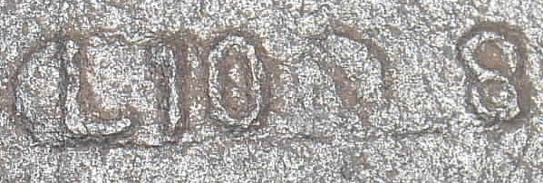

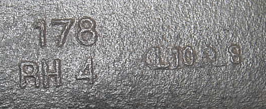

      Michael, here are a couple pics
      Here are a couple links to pictures - Do these look like '76 or '66?
      Was there absolutely no casting done on Sundays?
      Overview
      and
      Date Casting
      thanks...

        Dan,
        The casting date looks like B206, which would be Sunday, 20 Feb 66, or 76. I don't remember exactly when these manifolds were discontinued but I'm pretty sure they were still being cast in at least 1976 so it's possible they were over the counter items purchased after 1976.
        It's also possible that the Monday AM first shift in Feb of 1966 was still using the Sunday, 20 Feb date, for some reason. I know some plants started their Monday shift late Sunday night so that may be an explanation for the Sunday date.
