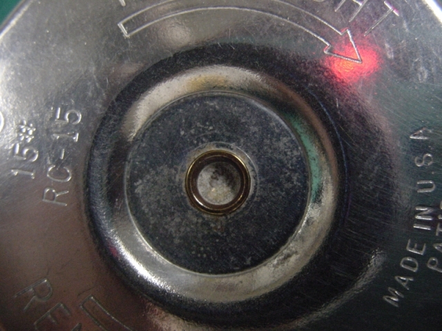

                  Here is a pic of the cap that is on my vette currently>

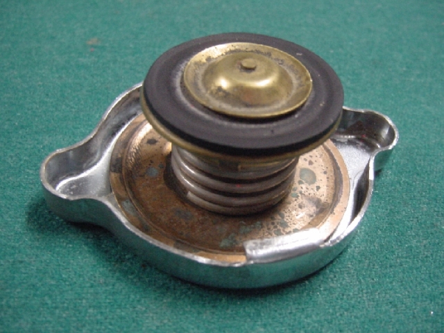

                  Also here is a pic of the bottom and a close up of the hollow rivet>
                  Since this is not the correct cap for my 67/427 no ac vette, what car is it correct for. I polished it up with Flitz to take the pic, it was dull.

                    That is what I currently believe to be the "first" design of the RC-15. It was used in Chevrolet passenger cars from 1963 through 1965. I'd bet that 75% of the judges wouldn't know it's not correct for your car. Well, at least until the article when they'll all have no excuse.
                    You REALLY polished that, didn't you?
                    Patrick
