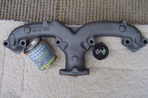

    Dear Members,
    Through much info and many emails I decided against the Calyx because its creme/polish texture doesn't dry. Apparently it stays moist/wet until there needs to be another application. I foresee myself reaching for something in the engine bay and getting the stuff on my sleeve or hand or somewhere else just to annoy me.
    I went with the Por-15 manifold paint. About a year ago I wire-wheeled a three foot section of the front frame rail on my 67. I brushed on their frame/chassis paint and it was Bullet Proof! So, I stayed with Por-15 again.
    It does look like they have been painted, so I'll probably take a few deduct points, but I know the coating will be armor-like and this makes me feel good about fighting off rust.
    Justin #41362

                        Re: Manifold Restoration
                        Justin,
                        They look great! Since my car is done being judged, I'd like to coat my exhaust manifilds with something that will last, but look like the original cast iron. Where did you buy the POR 15 manifold paint?
                        James West
