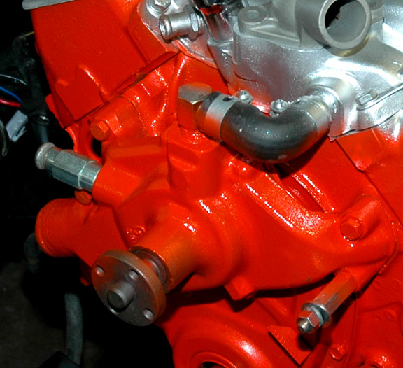

            • Collin MacDonald
              Re: 63 water pump? 340 hp
              Just finished installing one on my 340...here is a photo...
              • Joe R.
                • July 31, 1976
                • 4551
                Collin,
                If it ain't real you could fool me. You need to put a little more paint on the hose and loose the washers under the manifold bolts.
                Sorry, the devil made me do it!
                JR
                • Jack H.
                  • April 1, 1990
                  • 9906
                  Looks 'funky' to me...
                  The real McCoy '609 water pumps I've seen have NO 'flat' on the side of the upper boss to give clearance for deep dispersion water pump pulleys... The '185 water pump that followed the '609 had a slightly 'fatter' upper boss and DID have a flat on the side for pulley clearance. The '326 water pump that followed the '185 had an even 'fatter' upper boss and the flat on its side for pulley clearance was even MORE pronounced!
                  So, a picture of what's supposed to be a real McCoy '609 water pump with a flat on the side of the upper boss tells me something's wrong here...

                      Re: Looks 'funky' to me...
                      I have had 2 of these original 609 pumps and like Jack H. said, neither had the flat on the front of the bypass boss.
