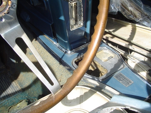

    Here's a shot of my 67 console with the #450 bright blue/white interior. This is an UNrestored part that had never been out of the car! It looks a little brighter than the radio panels. I'm not sure how much gloss has to do with the fiberglass of the panels and the potmetal of the console? Good Luck!
