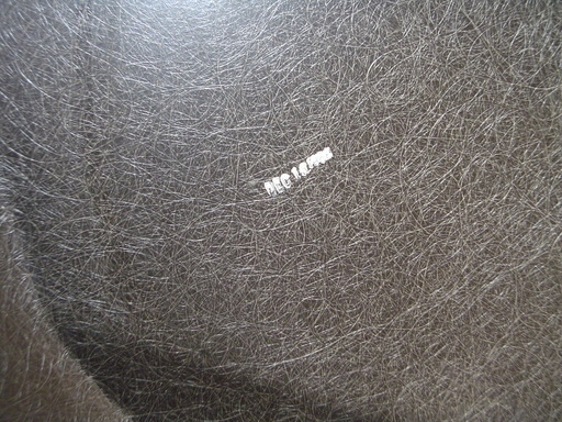

    Here's a shot of my Dec 1966 tire tub. I believe it's very close to the appearance of the heater box. I'd use a 3M rubbing compound like "Perfect It" I believe its called. I've used it before while colorsanding with great results, of course you'll need a wheel or hand polishing will take a long while. I know, because this is how I polished my plastic, speed-warning, gauge lenses!

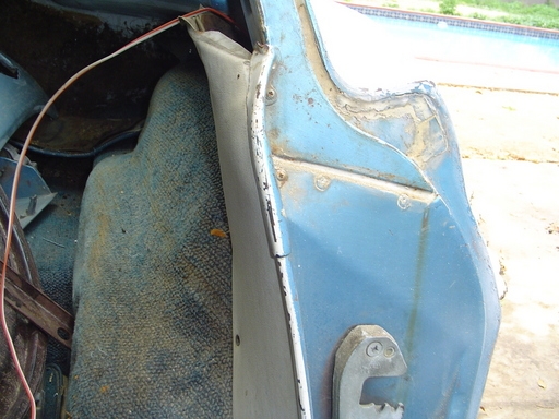

              coupe pinch weld screws
              Robbie,
              Here's a shot of my #450 interior and the pinch cap. BOTH screws are painted blue from the factory on my car. I don't know about others, but why would GM only shoot color on one of the screws. It seems the purpose is to hold the inner quarter panel flush at top, wouldn't both be tightened and in place?
